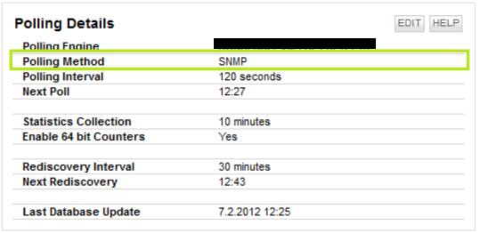

Verify that the polling method is SNMP and it is successfully polling your hardware health. To do so, go to the Node Detail page and locate the Polling Detail resource. This resource indicates the configured polling method for a node.
