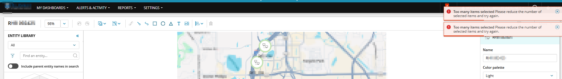

"Too many items selected. Please reduce the number of selected items and try again." Error in SolarWinds Platform Web Console
When navigating maps in the SolarWinds Platform Web Console, an error appears.
12/3/2025 4:47 PM
12/3/2025 4:47 PM
When creating or editing a map, it shows this error: Too many items selected. Please reduce the number of selected items and try again.
