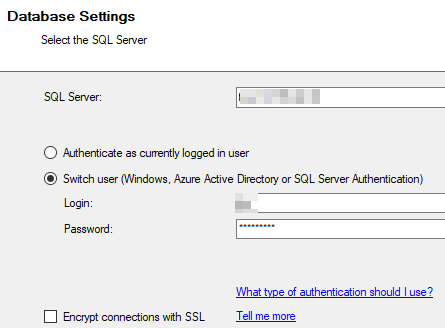

  4. On Database Settings, verify that the correct SQL Server and authentication method are selected. For SQL Server Authentication, check that System Administrator credentials of the SQL server are used and click Next. Use SQL Server Authentication to ensure that the SolarWinds Platform server can always access the database, even when hosted remotely on a separate server.

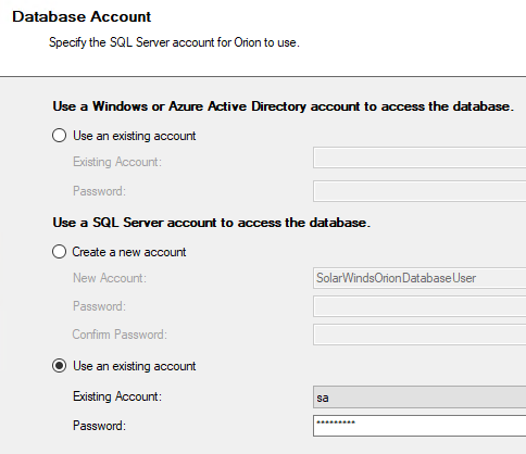

  6. On Database Account, ensure a valid account and password for an existing account is used, and click Next. You can also create an account. This account is used by the polling engine and by the SolarWinds Platform Web Console to access the database.

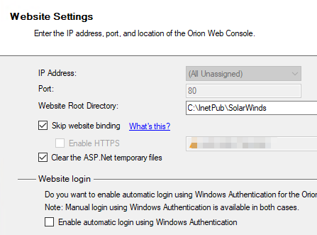

  7. On Website Settings, make sure the correct IP address, port, and location for the SolarWinds Platform Website are used and click Next.

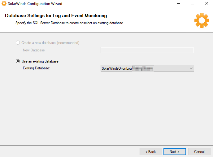

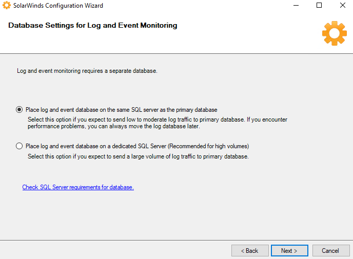

  1. Select the location for the Log Viewer database and click Next.
  2. Select the database to use and click Next.

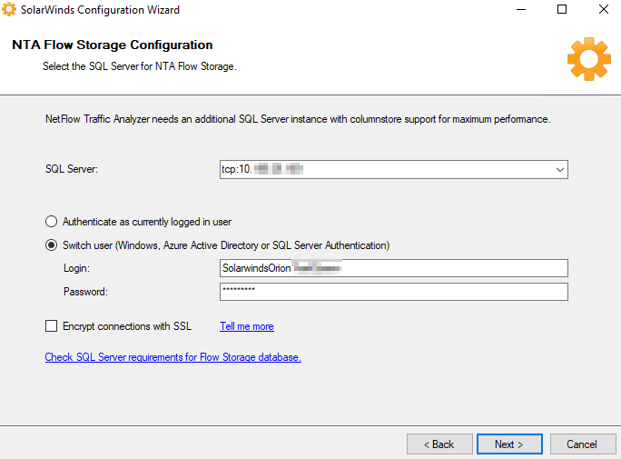

  3. Select the NTA SQL server location and credentials, then click Next.

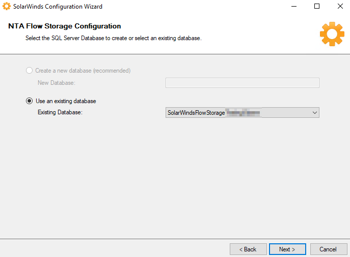

  4. Select the NTA database and click Next.

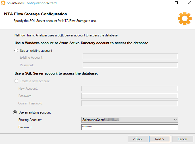

  5. Select the account credentials to use to connect to the NTA database and click Next.
