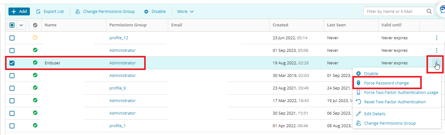

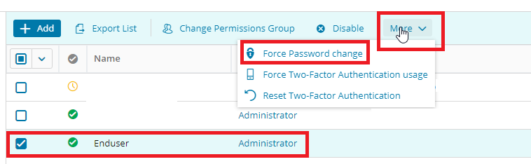

For Master Admin that wants to reset the DRE Password of the Technicians and End-User:
- Log in to the DRE Web Admin Page: https://admin.swi-dre.com.
- Go to Management > Technicians > Select the Technician.
- On the top top-menu or right menu of the selected Technician, click "Force Password Change."
If the Force Password change button is unavailable and the status of the user shows as Pending, the SSO for the user is not yet completed.
Please see the article: SSO activation steps in DRE
