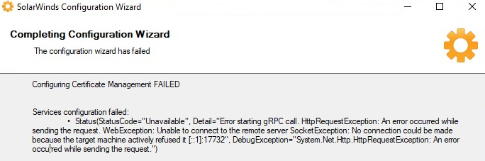

After upgrading to SolarWinds Platform 2024.4 and above and running the configuration wizard, the following error message may appear:
Configuring Certificate Management FAILED
StatusCode="Unavailable", Detail="Error starting gRPC call. HttpRequestException: An error occurred while sending the request. WebException: Unable to connect to the remote server SocketException: No connection could be made because the target machine actively refused it 127.0.0.1:17732", DebugException="System.Net.Http.HttpRequestException: An error occurred while sending the request.") ---> System.Net.Http.HttpRequestException: An error occurred while sending the request. ---> System.Net.WebException: Unable to connect to the remote server ---> System.Net.Sockets.SocketException: No connection could be made because the target machine actively refused it 127.0.0.1:17732
The Certificate Management Service (Solarwinds.CertificateManagementService.log) will fail to open connection to the SQL server with the following error message:
SqlException: A network-related or instance-specific error occurred while establishing a connection to SQL Server. The server was not found or was not accessible. Verify that the instance name is correct and that SQL Server is configured to allow remote connections. (provider: SQL Network Interfaces, error: 26 - Error Locating Server/Instance Specified)

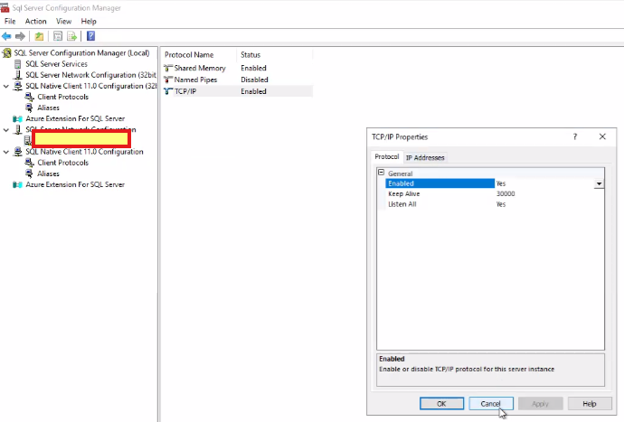

If an upgrade is not possible, you can workaround this problem by disabling "Force Encryption":
Try to enable Shared Memory protocol in SSCM
Restart SQL Server, and retry configuration wizard.

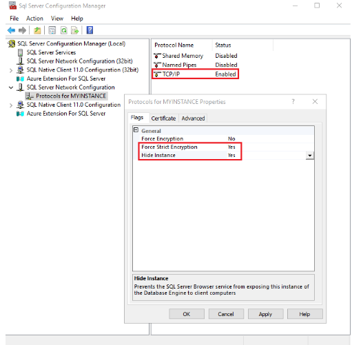

If it does not help set both protocol flags Force Strict Encryption or Hide Instance to No and re-run wizard.
If any of the SQL server protocol flags Force Strict Encryption or Hide Instance is set to Yes on SQL Server 2022
or flag Hide Instance is set to Yes on SQL Server 2019

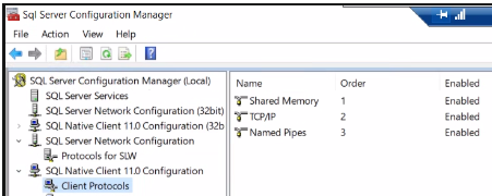

If the options above do not show, check the "Named pipes" option in SQL Server Configuration Manager, and enable it if it is disabled.
Once done, re-run the Configuration Wizard.
