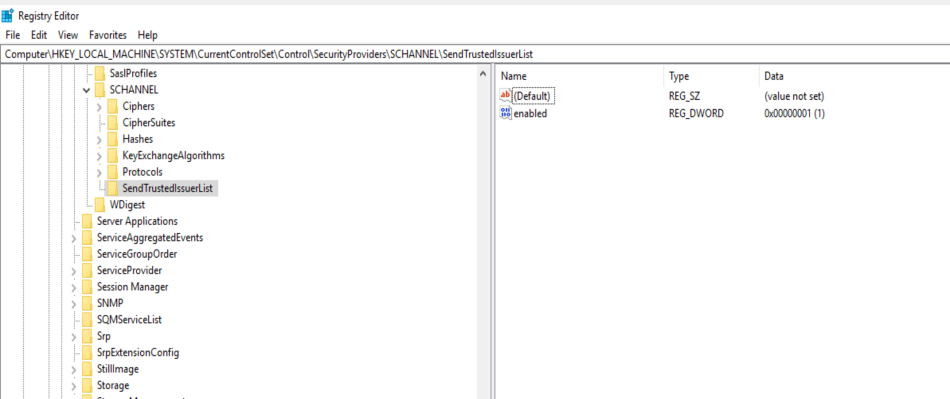

The issue arises because the Certificate Management Service (CMS) is designed to work exclusively with certificates stored in the Local Machine / My Certificate store.
HKEY_LOCAL_MACHINE\SYSTEM\CurrentControlSet\Control\SecurityProviders\SCHANNEL\SendTrustedIssuerList
However, the above registry setting when enabled (set to 1), interferes with the authentication process as described below:
  1. CMS uses two levels of authentication:
    • TLS level: Accepts any certificate.
    • Custom trusted store level: Validates the certificate chain and client certificate validity.
  2. With SendTrustedIssuerList enabled, the TLS-level authentication blocks client certificates because the required root certificates are located in the Local Machine / My store rather than in the trusted store location.
  3. This blockage prevents CMS from proceeding to the second level of authentication, resulting in the error "no client certificate found."
If this configuration is enabled, this limits the Configuration Wizard’s ability to issue a RabbitMQ certificate where the RabbitMQ service will not start properly due to the missing certificate and the upgrade will fail.
A fix for this issue is included in SolarWinds Platform 2025.4. Consider upgrading your environment. If you can't upgrade, use the workaround below.
To disable the registry setting, follow the below steps:
  1. Navigate to the registry path: HKEY_LOCAL_MACHINE\SYSTEM\CurrentControlSet\Control\SecurityProviders\SCHANNEL\SendTrustedIssuerList.
  2. Set the Enabled value to 0 (disabled).
  3. Restart the machine.
  4. Re-run the Configuration Wizard.
