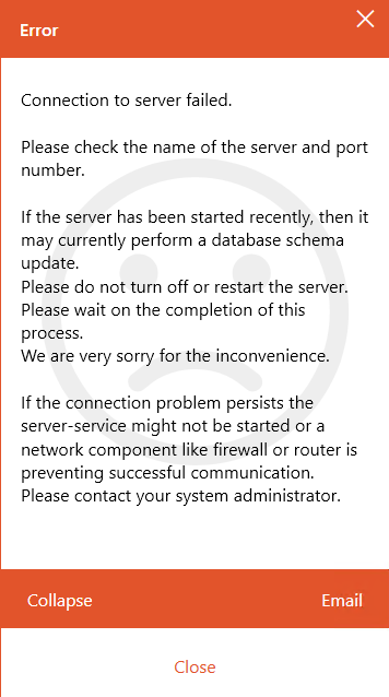

Starting in ARM 2024.3 and above, new architecture relying on certificate-based authentication for internal communication was implemented. These certificates expire exactly one year after creation and are not renewed automatically. When it expires, the ARM service fails to start properly and restarts continuously. No user login is possible, and typical recovery actions such as reinstalling, restoring backups, or modifying configurations do not resolve the issue with the following error message:
Connection to server failed.
Please check the name of the server and port number.
If the server has been started recently, then it may currently perform a database schema update.
Please do not turn off or restart the server. Please wait on the completion of this process.
We are very sorry for the inconvenience.
If the connection problem persists the server-service might not be started or a network component like firewall or router is preventing successful communication.
Please contact your system administrator.

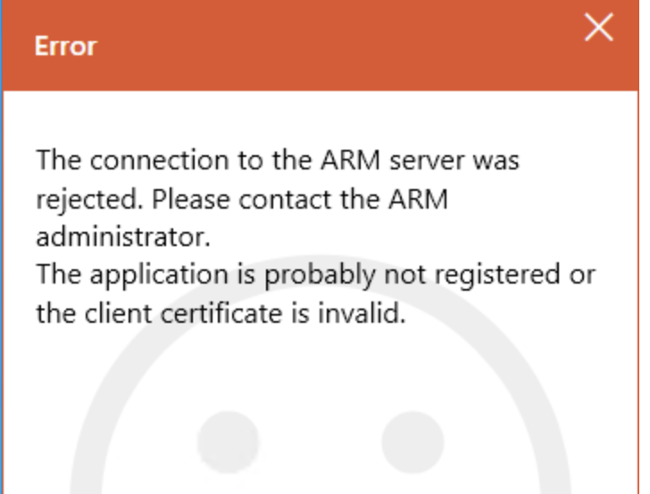

Example screenshot:
The connection to the ARM server was rejected. Please contact the ARM administrator. The application is probably not registered or the client certificate is invalid.
