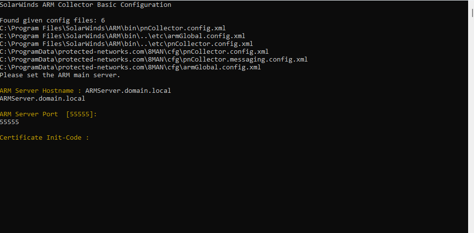

  • At the last step, you will see a prompt like the following.
  • Please enter the related ARM Server FQDN of your environment and confirm by pressing the enter key for the default ARM port (55555), or enter the port you have configured if you have a custom one.

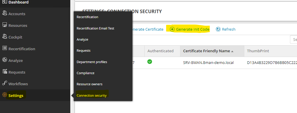

  • You need to generate the certificate Init-Code in the ARM Web client under 'Connection security', as shown below. Then, copy and paste the code generated where it is required, as shown above. You will need to login to the Web Console as an Admin level ARM user.
  • If you miss the above prompt during the collector installation you can run it again by executing the ARMcollectorconfigurator.exe program found in C:\Program Files\SolarWinds\ARM\bin on the collector machine, as a local administrator.
