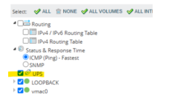

SolarWinds relies on the Manufacture Date OID '1.3.6.1.4.1.318.1.1.1.1.2.2.0' as a required attribute to determine whether a discovered SNMP node should be identified as a UPS (Power Control Unit).
Historically, all APC UPS devices returned this value in a consistent numeric date format. Newer Schneider firmware versions have changed this format to a string-based representation, which causes the UPS detection logic to fail during the inventory step.
Because this value is mandatory for UPS classification, the failure prevents SolarWinds from discovering the UPS Poller and appears to be missing in the List Resources.
