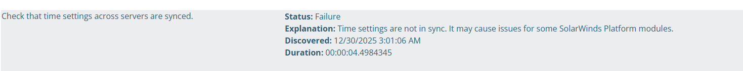

This issue will also typically be flagged in Active Diagnostics:
Orion Platform
Requirements and recommendations
Before you begin, be sure your scalability engine servers meet the following requirements:
  • Installing an APE and an additional web server on the same host is not supported.
  • All APEs must be set to the same time zone as the SolarWinds Platform database server.
  • If APEs and the SolarWinds Platform database server are set to different time zones, polled data can be confusing or misleading. For example, data can have a time stamp that is in the future.
