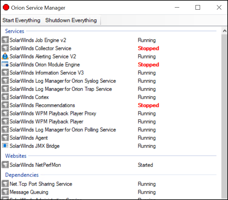

Upon reviewing the services using the SolarWinds Platform Service Manager, you'll notice that some of them have stopped; SolarWinds Collector, Recommendations, Module Engine, etc. However this can also be caused by a stopped Application Pool in IIS.

SQL account used by the SolarWinds Platform is unable to logon to the database because its password is expired.
- Contact your DBA to remove 'Enforce password expiration' on the SQL account used by the SolarWinds Platform.
- How to Start, Stop, or Restart SolarWinds Services with the SolarWinds Service Manager in the SolarWinds Platform
- Reboot the SolarWinds Platform Server.
Note: Also check the SQL database if its accessible and there are enough disk space to operate.
