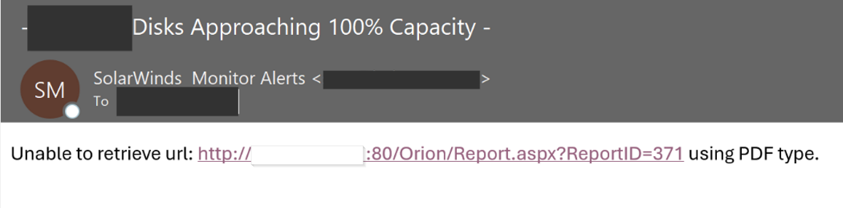

This article is created to address the issue when sending a PDF using the report scheduler and it shows an error instead of having a PDF attachment. Unable to retrieve url: https://FQDN\:443/Orion/Report.aspx?ReportID=635 using PDF type.

The PDF report when sent via report scheduler via email is missing
