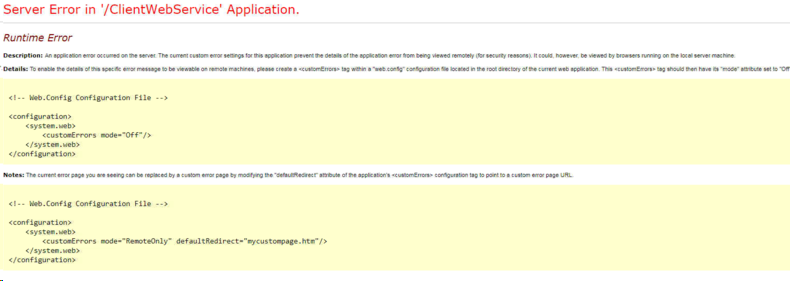

As there are multitudes of reasons why the behavior can be observed, to dig deeper and understand, turning Custom Errors mode to Off can help.
Turn Custom Errors mode to Off
To confirm the issue, perform the following steps:
  1. Navigate to C:\inetpub\SolarWinds (for 2020.2.6 and older) and C:\Program Files\Solarwinds\Orion\Web (for 2022.1 and newer)
  2. Open the web.config file
  3. Modify the line <customErrors mode="On" /> to <customErrors mode="Off" />
  4. Save Changes
  5. Open a web browser and try to reach the SolarWinds web console.
A detailed error message and stack trace will be provided.  Please copy all details and open a SolarWinds Support Case to help determine the root cause.

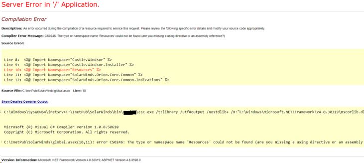

This error message means that the issue is caused by our website being precompiled for a performance boost. You can disable the precompilation process by following the steps in this Thwack post.
  • Once done, the website will need to be rebuilt according to the steps in this article.

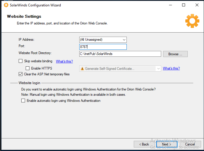

Run the configuration wizard and select the 'All Unassigned' option in the web settings section and choose port 8787:
If you don't receive an error at the end of the Configuration Wizard you should be able to re-enable HTTPS via the following steps:
