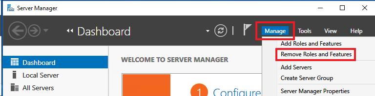

  2. Run Server Manager, go to Manage > Remove Roles and Features.

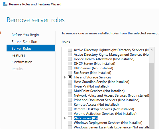

  3. Go to Server Roles and uncheck Web Server (IIS)

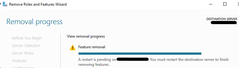

  4. Follow the on-screen instructions to complete the steps to uninstall the IIS.
  5. Restart the server after the IIS is uninstalled:image.png

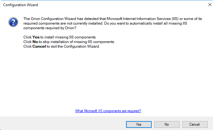

  6. Run the Configuration Wizard as administrator.
  7. Click Yes for the confirmation to install any missing IIS components. You may need to reboot the server a second time.
  8. Follow the on-screen instructions to complete the Configuration Wizard.
