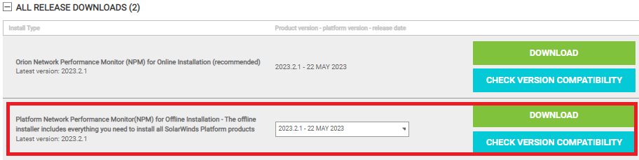

  1. Download the ISO file (offline installer) for the latest version. You can download it from the customer portal download page. Use a different PC to download the installer and move it to the Orion server.
    • Make sure to select the latest dated ISO file.
