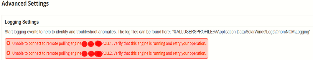

Sometimes you encounter the following error when you try to access NCM Features:
Unable to connect to polling engine XXXXXXX on the relevant server. Verify that NCM 7.7 or later is installed on the server
The error above can be generic in nature. The resolution below is specific to a particular issue that can be identified by a particular error that you see in the NCM Business layer log on the polling engine referred to in the error message.
The error is also seen in the Orion web console when you browse the Advanced NCM job settings page,
