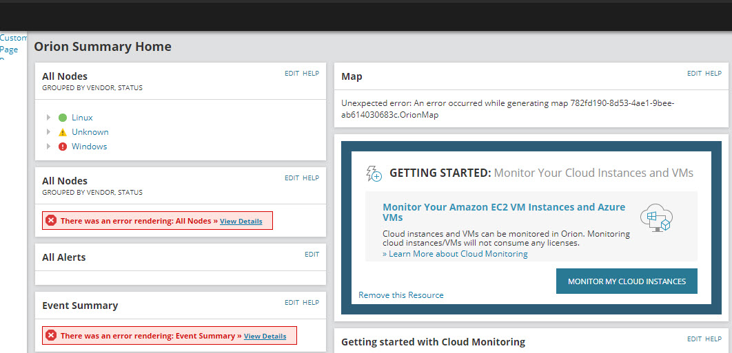

After logging in to the SolarWinds Platform Web Console, you may find that the menu bar does not load as expected. There may also be rendering errors on widgets and a communication error in the top right corner of the page in red.

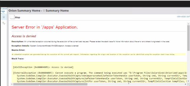

Permission issue indicating that the ASP.NET application is unable to execute a required program (csc.exe), which is a Web compiler used by the SolarWinds Platform.
You might encounter an error as well loading the Map in an Intelligent Map Widget:
[HttpException (0x80004005): Cannot execute a program. The command being executed was "D:\Program Files\SolarWinds\Orion\Web\apps\bin\roslyn\csc.exe" /shared /keepalive:"10" /noconfig /fullpaths @"C:\Windows\Microsoft.NET\Framework\v4.0.30319\Temporary ASP.NET Files\apps\0d9b9df5\f422d218\gv4fqflm.cmdline".] System.Web.HttpRuntime.FirstRequestInit(HttpContext context)

    Resolution 13
    • Navigate to C:\ProgramData\Solarwinds
    • Right Click Key Storage and Select Properties
    • Click Advanced
    • Remove the SolarWinds Application Pool Permission Entry  with type "Deny" and Click Apply
    • Refresh SolarWinds Web page and the Menu bar should be present
