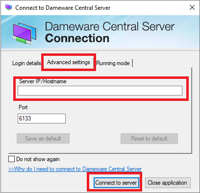

- Direct all of the DRS and DMRC client machines to the Host Name /IP Address of the new Server by updating the Dameware Central Server IP/Hostname as shown below:

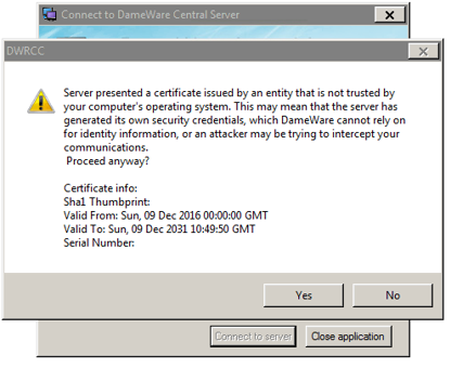

- The following prompt is expected as the new server has a new certificate unknown to the client. Once accepted, it should work as expected:
