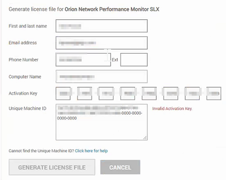

On the customer portal, when you try to create an offline license, you get the message Invalid Activation Key.

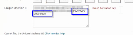

The UMID is not in the correct format as it contains 0000-0000-0000-0000 at the end.
The user navigated to Settings > All Settings > Details > License Manager and clicked the Add License tab. Instead, they should have selected a license and used the Activate/Upgrade option.
Follow the below steps to be able to complete the manual registration:
- To retrieve the UMID that will work in the customer portal, go to Settings > All Settings > Details > License Manager in the SolarWinds Web Console.
- Click on the box to the left of the license (e.g NPM)) and either click the activate/upgrade option. That UMID will not have 4 sets of 0000 at the end and will be usable the customer portal so you can complete the manual registration yourself.
