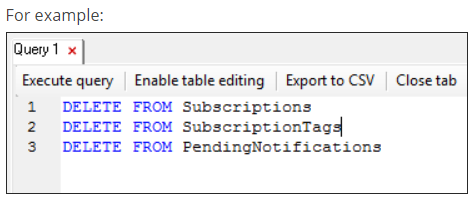

  5. Enter the following queries:
    DELETE FROM Subscriptions
    DELETE FROM SubscriptionTags
    DELETE FROM PendingNotifications;
  6. Click Execute query.
