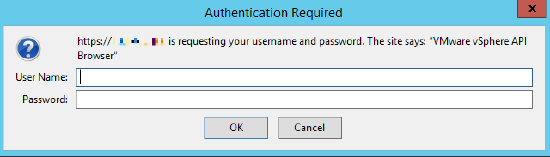

  • Unable to access https:\\<VCenter>\mob
  • Credentials are not the same the one used to access https:\\<VCenter>\mob
  1. Confirm the Polling Engine where the VCenter is on, as it is Engine-dependent.
  2. Log in to the Polling Engine via Remote Desktop (RDP).
  3. Open an Internet browser.
  4. Ensure that you are able to connect to https:\\<VCenter>\mob.
    ** Replace <VCenter> with the hostname or IP address of the VCenter.
    1. If you are not able to even reach the page, firewall rules might be preventing connection.
    2. If you are using the IP address, there will be a warning, indicating that the page is insecure. Just proceed.
  5. You will be presented a prompt to access the https:\\<VCenter>\mob.
  6. The User Name and Password will be the one that will be used in Orion.

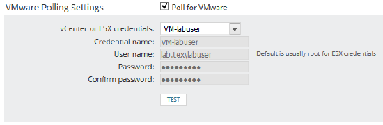

In the Orion Web Console:
  1. Click Settings > Manage Nodes.
  2. Select the checkbox next to the Node and click Edit Properties.
  3. Fill in the rest of the information as needed.
  4. To poll for VMware information, click on the Poll for VMWare checkbox.
  5. It will expose the following settings that should be completed:
    ** Note that User name and Password must be the same as used to access https:\\<VCenter>\mob.
  6. Click Test to validate the credentials, and Submit the changes.
