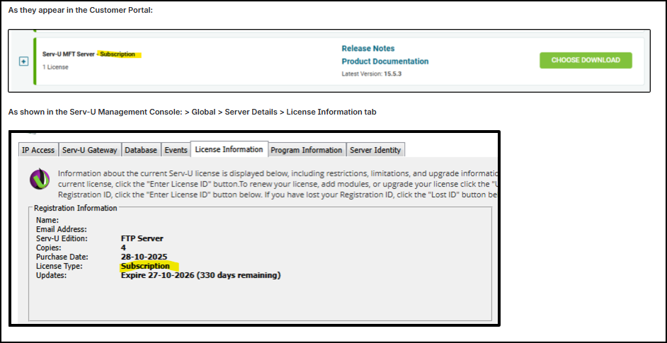

Subscription License:

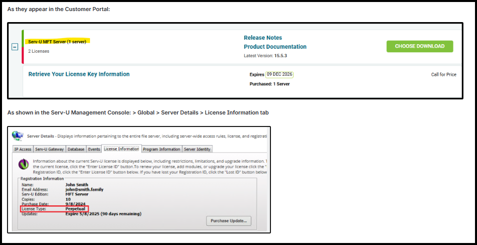

Perpetual License
Please note that the Subscription License key will only work with the latest version 15.5.3.106.

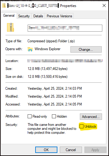

    1. Access the downloaded zip file for the installer and make sure to extract the contents.
    2. Right-click the Serv-U MFT 2026.3 installer and select Properties.
    3. Click "Unblock" if available.
    4. Right-click the Serv-U MFT 2026.3 installer again, and then run the installer as an administrator.

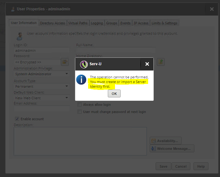

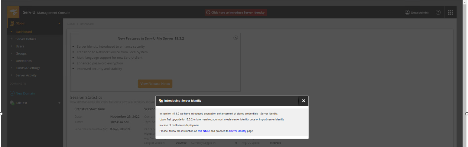

    If you are upgrading to the latest version from 15.3.1 or older:  the Management Console will now display a new banner message about creating a Server Identity.
    This is a mandatory setting that needs to be enabled for this version. If not configured, the Serv-U Administrator can no longer manage the Management Console and will be getting the error messages below:
    Graphical user interface, text, application  Description automatically generated
    Proceed with the creation of the Server Identity. It is also very important to Export a copy of the Server Identity after the upgrade.
    Take note that setting up the Server Identity for a single instance deployment is different than multi-instance deployments

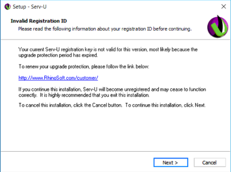

    If there is a message about an Invalid Registration ID while running the Serv-U 15.2.5 installer, click NEXT and proceed with completing the upgrade.

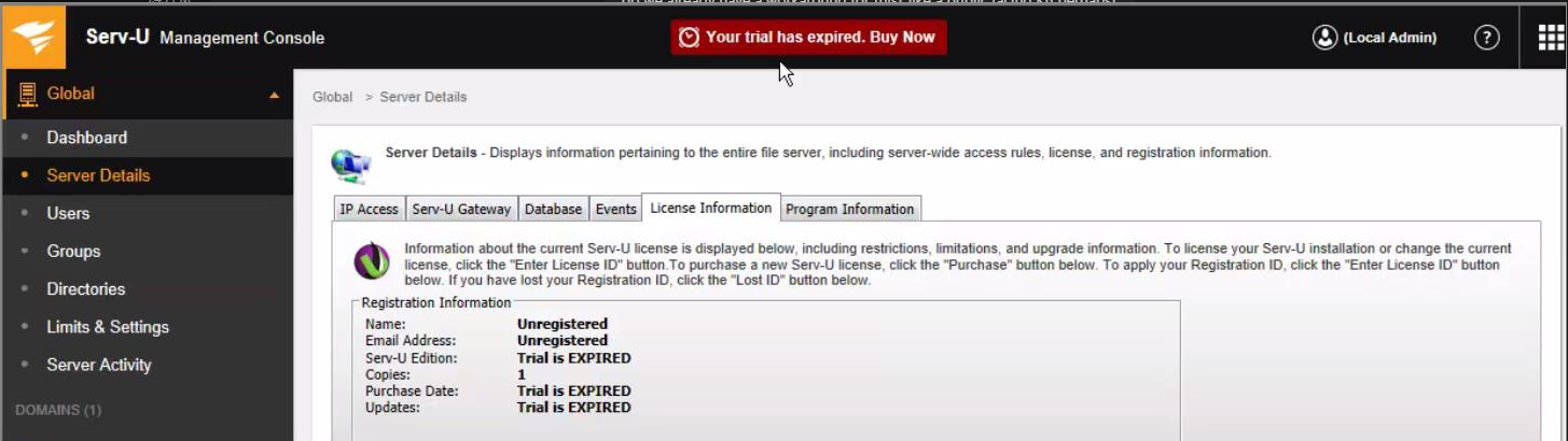

    If you are upgrading from version 15.2.2 or older, after the upgrade is complete, the Serv-U Management Console will show a "Your trial has expired" banner. This is expected as version 15.2.3 and newer requires the new license key.
    Proceed with manually entering the license key from the Customer Portal page, into the Serv-U Management Console by following the steps below.
    1. Open the Serv-U Management Console.
    2. Go to Server Details > View information about and configure the current license.

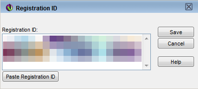

    3. Click Enter License ID...
    4. Paste your alphanumeric Registration ID string in the Registration ID field.
    5. Click Save.

    1. While running the installer file, if there is a window that says your registration ID is invalid, please disregard it and just continue with the prompts.
    2. If after the upgrade process and Serv-U shows you have an expired license, just reapply your MFT license.
      • Copy your Serv-U MFT license from the Customer Portal page.
      • Back in Serv-U, go to Management Console > Global > Server Details > License Information tab > scroll to the bottom left part of the page and click Enter License ID, and paste your MFT license there
