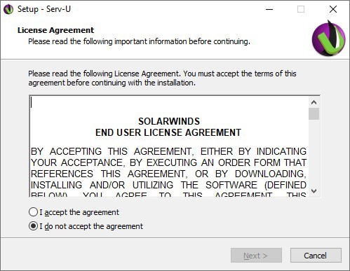

  • Installing Serv-U by means of the Serv-U Setup program:

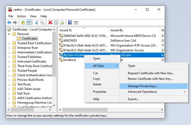

  1. From the command line, start the local computer certificate manager:
  2. In the started Certificate Manager, launch Manage Private Keys for the certificate ftp.serv-u.com that resides in Certificates – Local Computer\Personal\Certificates storage:

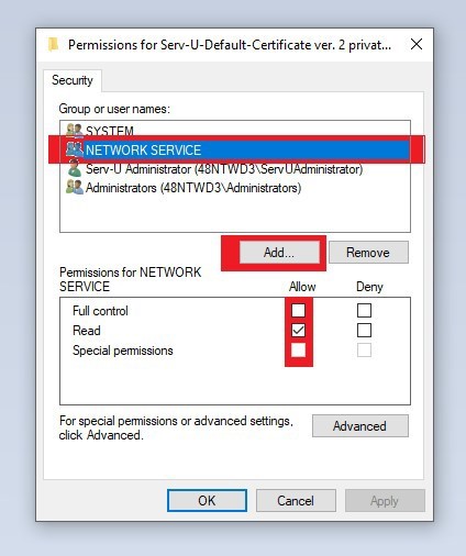

  3. Verify "read" permission is granted to NETWORK SERVICE. If not, add it manually:

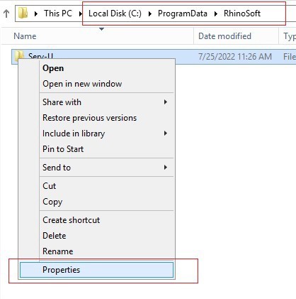

  1. In Windows File Explorer, open the Properties box for the Serv-U Program Data directory:

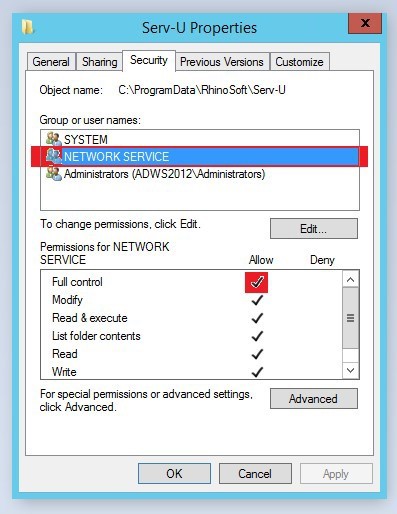

  2. Verify there is "full control" permission granted to NETWORK SERVICE. If not, add it manually:
    If the Serv-U Program Data directory is the same as the Serv-U install directory, use the install directory (by Default it is C:\Program Files\RhinoSoft\Serv-U). When this permission is granted, the service account will allow Serv-U to automatically apply the required access rights to the data files, such as:
