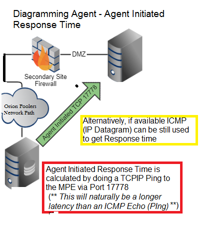

ICMP is a low-level messaging protocol. Because of its simplicity, it is impossible to accurately record the same response time values using a different protocol. For example, Agent messaging will report a response time in the 490-850 ms range, but a typical ICMP response time will do it in 150 ms.
Status & Response Time Agent messaging enabled in the List Resources page triggers the Agent to use the TCP port 17778 and do a 'pseudo-ping' -or- TCP ping instead of a basic 'Datagram' ping used by ICMP.
  • ICMP pings are much faster as they use an IP Datagram packet.
  • TCP pings are slower due to the extra processing load to get verification in the network.
Diagram:
Even though ICMP pings are faster, in some cases, you may still want to use Agent polling. Please look at Poll devices with SolarWinds Orion agents for more information.
SolarWinds recommends using ping (if possible) because this has the best consistency and is the fastest.
