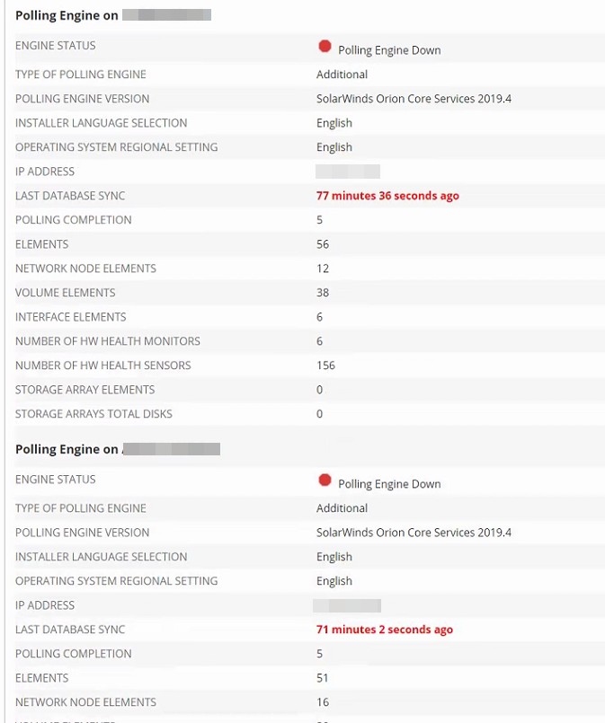

Steps to take if the Last Database Update is more than 60 minutes and Last Database Sync is showing a high value and Data is not polling on the Polling Engine. Repairing services, repairing Orion core services, Example: -Last database sync is high E.G. 60 minutes and 3 seconds ago. -Polling engines not updating correctly. Polling engines page showing red database sync status -Data is not polling correctly

When you go to Settings > All Settings > Polling Engines, the Last Database Update is showing a high value. There are many reasons for a high database sync value, all issues trace back to the polling engine not being able to communicate with the database. This article lists the most common causes for such an issue and how you can resolve it.
