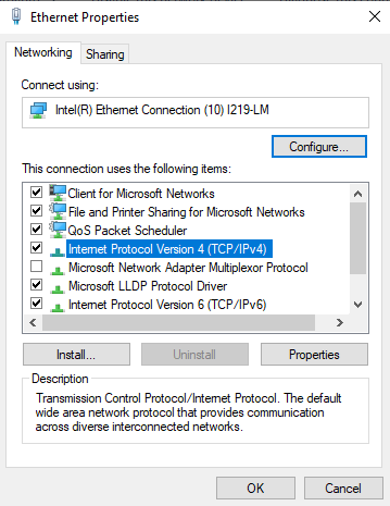

  1. Right-click on the network adapter you want to prioritize, and select Properties.
  1. Highlight the Internet Protocol Version 4 and select Properties.

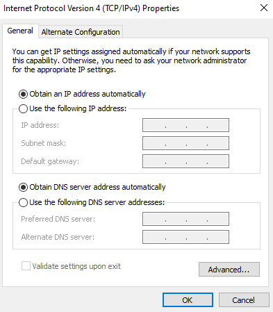

  1. In the "General" tab click the Advanced button.
  1. At the bottom of the window, uncheck Automatic Metric if is checked and put 1 for Interface Metric. This assigns the NIC to the database and should receive the correct IP.
