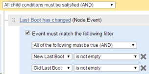

Workaround if the "Lastboot" value is NULL in the Nodes Table and those nodes cause false reboot alerts.
1) Edit “Node rebooted alert” or the alert in question (it’s canned – so copy it and disable the canned version)
2) Change trigger condition
3) Check the tick box for “Event must match the following filter”
4) New Last Boot is not empty AND Old Last Boot is not empty
