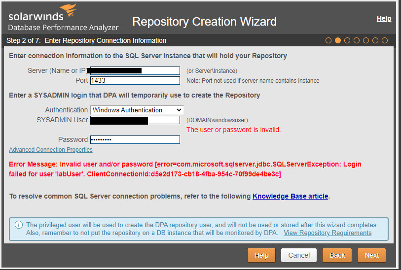

Unable to register a SQL Server database instance as a repository with a domain user
- Open the Repository Creation Wizard.
- Choose Microsoft SQL Server.
- In step 2, choose Windows authentication and set a domain user with a correct password.
- Click the Next button.
- Examples of the errors on the screen and exceptions from the Wizard.log file are shown below.
DEBUG (2021-10-01T11:21:50,407-0500) [https-jsse-nio-8124-exec RepositoryCreationServiceImpl:682 - Connection to database failed [exception=com.confio.ignite.common.jdbc.exceptions.DatabaseConnectionException: A connection to the database could not be established: Invalid user and/or password [cause=org.springframework.jdbc.CannotGetJdbcConnectionException: Failed to obtain JDBC Connection; nested exception is com.microsoft.sqlserver.jdbc.SQLServerException: Login failed for user 'example_user' ClientConnectionId:0e42f56b-ad06-4c17-a197-1925aa20a11a]]

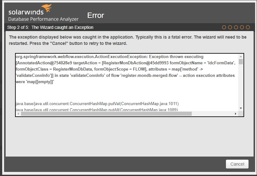

Example error 2:
Exception thrown executing [AnnotatedAction@103ab220 targetAction = [RepointMonDbAction@7886fa5f formObjectName = 'idcFormData', formObjectClass = RepointMonDbData, formObjectScope = FLOW], attributes = map['method' -> 'validateConnectionInfo']] in state 'validateConnectionInfo' of flow 'repoint-mondb-flow' – action execution attributes were 'map[[empty]]'

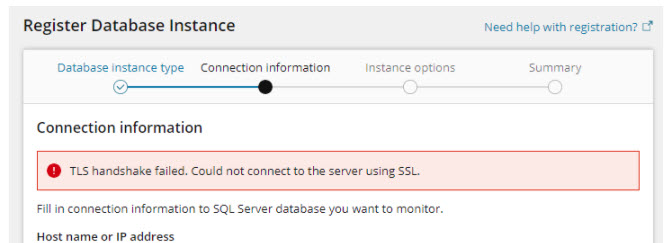

Errors for TLS_HANDSHAKE
The following errors can occur when you are creating the repository, registering a SQL Server instance for monitoring, or updating a connection for an existing monitored instance.
INFO (2021-10-06T12:14:42,146-0400) [http-nio-8123-exec-1] WizardFormAction:272 - TLS_HANDSHAKE_FAILED: The server selected protocol version TLS10 is not accepted by client preferences [TLS13, TLS12] com.solarwinds.common.network.error.NetworkingException: TLS_HANDSHAKE_FAILED: The server selected protocol version TLS10 is not accepted by client preferences [TLS13, TLS12]

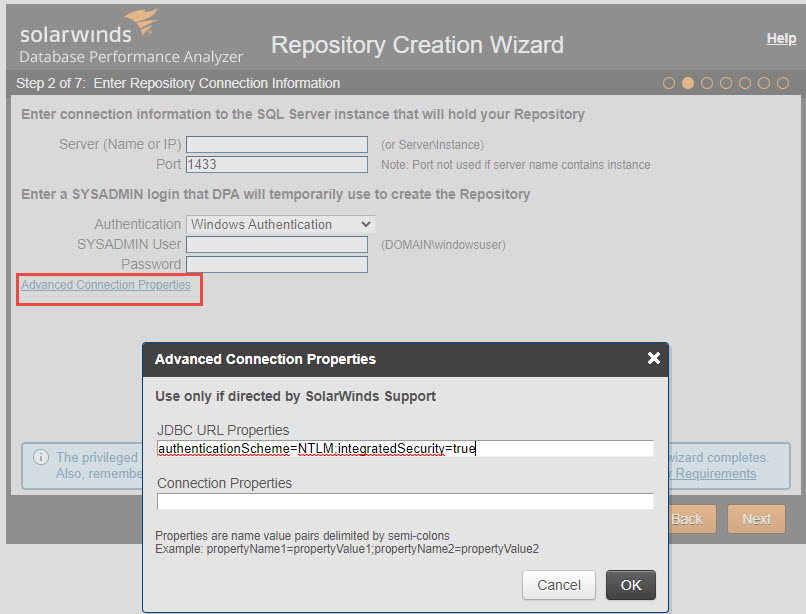

Option 1: Add connection properties
- On the screen with the error, click "Advanced connection properties".
- Enter the following string in JDBC URL Properties box:
authenticationScheme=NTLM;integratedSecurity=true - Click OK.

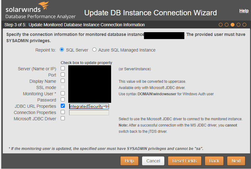

Unable to update a domain user for a monitored SQL Server database instance: Workarounds
In the Updated DB Instance Connection Wizard, select JDBC URL Properties and enter the following in the text box:

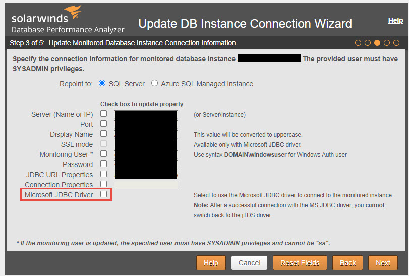

Option 2: Switch to the jTDS driver
In the Updated DB Instance Connection Wizard, select the Microsoft JDBC Driver option. Note: This box is present only for instances that were registered in a previous DPA release.
Errors for TLS_HANDSHAKE: Workarounds
Option 1: Update the SQL Server instance to support TLS 1.2
Patch SQL Server to a newer Service Release or Cumulative Update that contains support for TLS 1.2 or later. Microsoft documentation stating the patch levels required per SQL Server version to support TLS 1.2 Microsoft patches can be found here.
