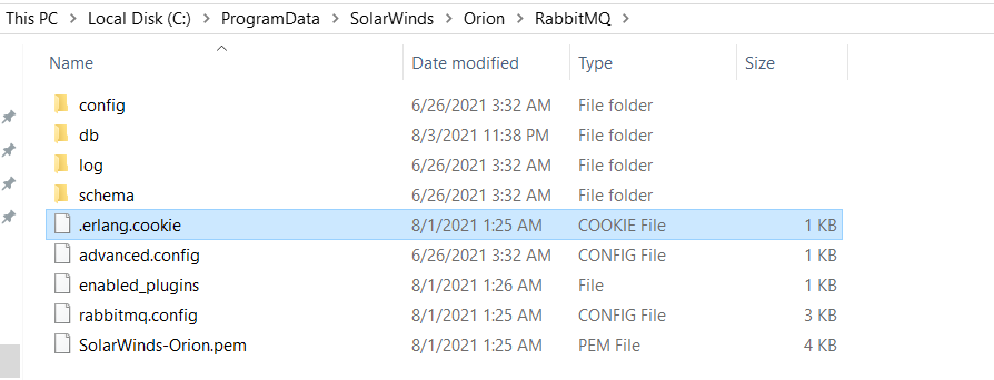

  3. Navigate to “C:\ProgramData\SolarWinds\Orion\RabbitMQ” and delete “.erlang.cookie” (create backup in case needed)

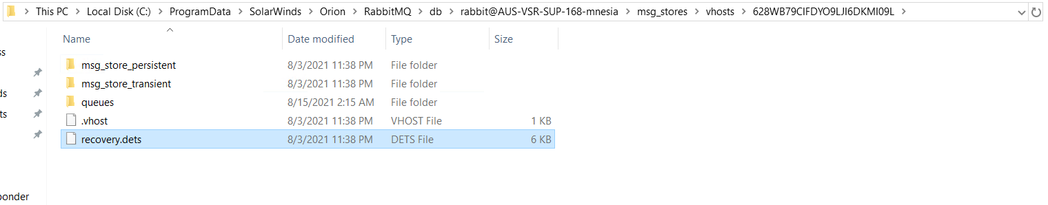

  1. Navigate to “C:\ProgramData\SolarWinds\Orion\RabbitMQ\db\rabbit@<hostname>mnesia\msg_stores\vhosts\628WB79CIFDYO9LJI6DKMI09L” and deleted “recovery.dets” if size is not 6kb

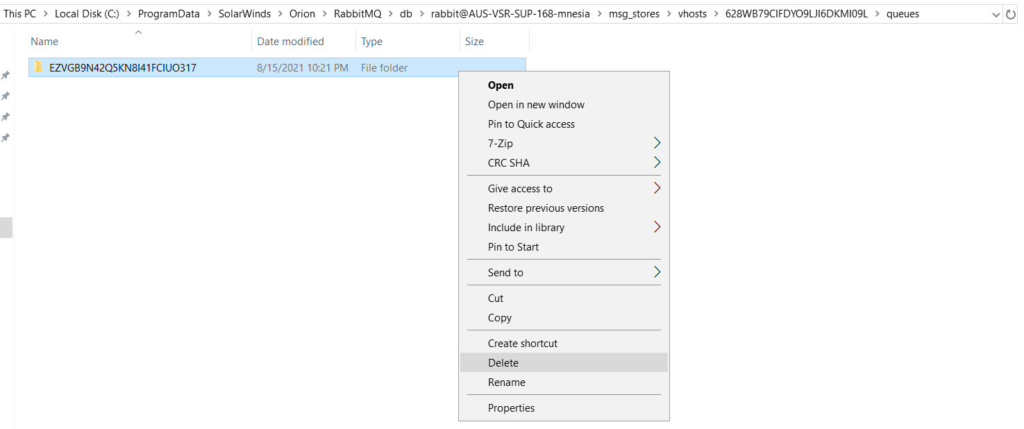

  1. Click "queues" and delete folder's content (not the folder)
