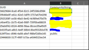

After you Identify the Community String, proceed to step two, and remove the duplicate entry. (In the example below, we'll remove "jk_pub_can")
* This can also occur with ICMP entries as shown below highlighted yellow.
