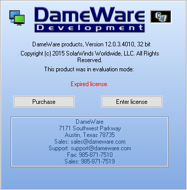

However, in some cases, the activation is successful, but when you open Dameware, it shows that the license is expired.

Though activated, you'll get the license expired pop-up soon after launching Mini Remote Control. This is due to some background processes that require administrative permissions (such as processes that will only run when launched by the local or domain administrator logged in to the computer).

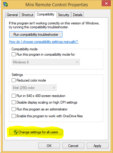

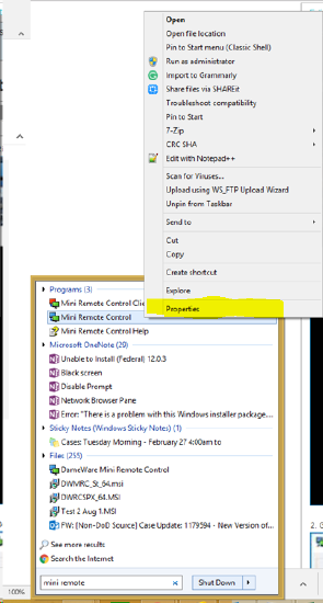

  1. Right-click the Mini Remote Control icon and choose Properties.
  2. Go to the Compatibility tab and click Change settings for all users.

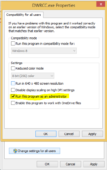

  3. Select Run this program as an administrator, and click OK to continue.

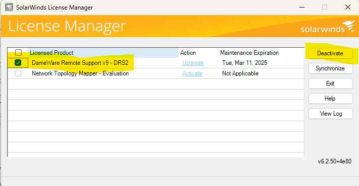

  1. Install SolarWinds License Manager, which is downloadable from the SolarWinds Customer Portal. Make sure version 6.2 and above.
  2. Launch the License Manager as an Admin.
  3. Check on the Dameware product, then click the Deactivate button on the right menu.
  4. Complete Online Deactivation. If online fails, try offline: Dameware License Offline Activation and Deactivation when Dameware Online Activation is Failing
