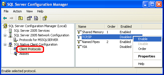

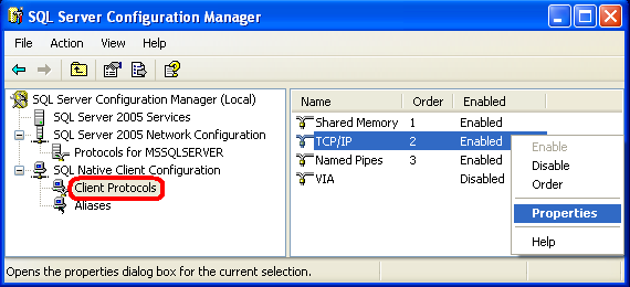

A: Ensure that TCP/IP is enabled by viewing the following settings in the SQL Server Configuration Manager for the SQL Server instance. If either of the following are disabled, they must be enabled to proceed with DPA registration. (If your SQL Server Administrator will not allow this, see this article: Connect to SQL Server using named pipes.)

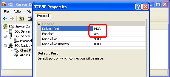

A: If you have specified only a Server and not a Server\Instance, ensure that the Port entry is correct and that the instance you are trying to register is the default instance. To determine the port for a default instance, open the SQL Server Configuration Manager for the SQL Service Instance, select the TCP/IP Properties, and enter the Default Port value in the port field on the wizard.
Q: My SQL Server Administrator will not turn on TCP/IP for the SQL Server instance. What can I do?
A: By default, DPA connects to SQL Server instances via TCP/IP. If the instance cannot be configured for TCP/IP connections, DPA can be configured to connect using named pipes. See Connect to SQL Server using named pipes for detailed instructions on how to enable Named Pipe connections in DPA.

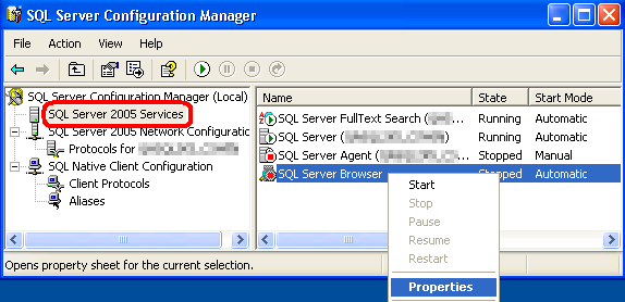

Q: I specified a Server\Instance to register a named instance but received the error "SQL Server Instance could not be retrieved."

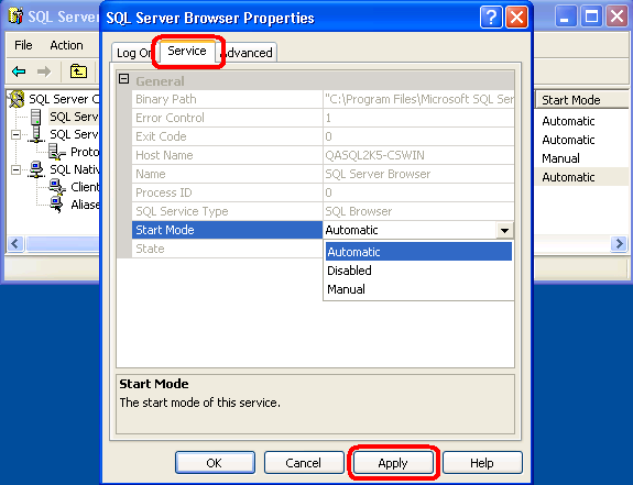

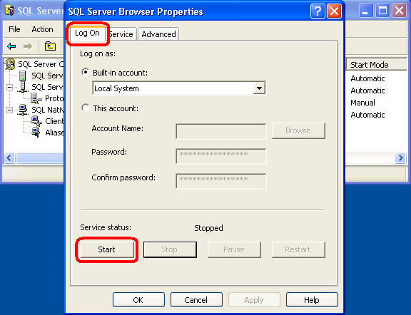

A: Ensure that the SQL Server Browser Service (SQL 2005 and up) or the SQL Server Resolution Protocol (SSRP) listener service (SQL 2000) is Started and has a start mode of Automatic on the SQL Server host. (Note: If the start mode is not set to Automatic, DPA cannot connect to the SQL Server instance if you restart the SQL Server host but do not remember to start this service manually.)
Select the Service tab to ensure that the Start Mode is set to Automatic for the SQL Server Browser, and click Apply:
Click the Log On tab to start the service if it is stopped:
Once the service starts, click OK and return to the Register Instance Wizard to continue.

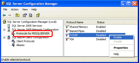

Q: I specified a Server\Instance to register a named instance but received the error "Could not get JDBC Connection; nested exception is java.sql.SQLException: Server SERVER has no instance named INSTANCE."
A: Make sure the Server and Instance information was entered correctly.
A: Make sure that TCP/IP is enabled for this instance by viewing the following settings in the SQL Server Configuration Manager for the SQL Server instance. If either of the following is disabled, they must be enabled to proceed with DPA registration. If your SQL Server Administrator will not allow this, see this article: Connect to SQL Server using named pipes.

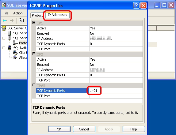

Q: My SQL Server Administrator will not turn on the SQL Server Browser. What can I do?
A: In order to register a named instance without having the SQL Server Browser enabled, TCP Dynamic Ports must be enabled and set to a value. To find this value, open the SQL Server Configuration Manager for the SQL Service Instance, select the TCP/IP Properties for the SQL Server Network Configuration Protocols, and then click the IP Addresses tab.
When you have the TCP Dynamic Ports value, enter only the Server value (not the Server\Instance value) in the Server field of the Register Instance Wizard and enter the TCP Dynamic Ports value in the Port field to continue.

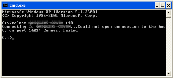

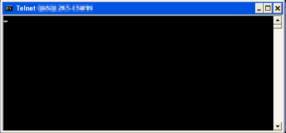

Q: I requested that the SQL Server Host and Port combination be opened on our firewall, but I am still getting errors. How can I tell if our IT department has actually opened the ports so I can register our SQL Server instance?
A: Use Telnet to check that a TCP connection can be established to the SQL Server host and port. If the Telnet connection fails, the SQL Server Host and Port combination has probably not been opened for access from the DPA server.
To determine if the port is being blocked by a firewall, open a command prompt and type:
telnet SERVER PORT
Where SERVER and PORT are the known server hostname or server IP address and port combination that SQL Server is running on. An unsuccessful or blocked TCP Connect will show the following:
A successful TCP Connect will change the command prompt to a Telnet window:
