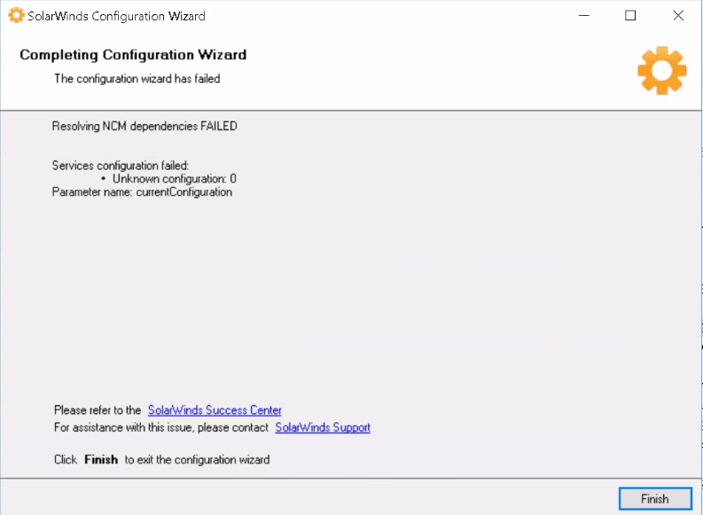

Version: 2022.3.0
- Configuration Wizard:
- Configuration Wizard Log;
2022-10-26 03:31:37,912 [5] ERROR TaskAdapter - Error running task Cirrus.Tasks.NcmServices Resolving NCM dependencies System.ArgumentOutOfRangeException: Unknown configuration: 0 Parameter name: currentConfiguration
- Manually copy root package files from <installpath>\Program Files (x86)\SolarWinds\Orion\Packaging\Roots Main Poller to Additional Polling Engine where you are getting the error.
- Re-run the Configuration Wizard.
- If still same error, then refer to Uninstall all Orion Platform products from a server and prepare for reinstall
- Run the Configuration Wizard after re-installation.
