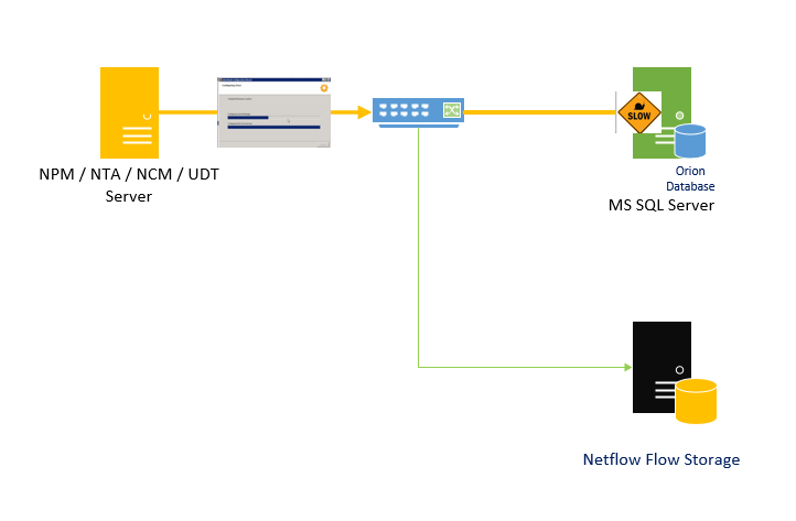

If it is a recent database migration:
- Check the Orion Database Size and Locating your Orion database properties and storing your DB files set to the single disk array. The disk is under pressure, creating some latency when running the Configuration Wizard.
- Shrink the size of the Orion Database reduced the size from 60 Gig to 30 Gig (50%)
- Re-boot the SQL Server and manually complete the Database Maintenance; Re-run the Configuration Wizard once again by going to Start > run > All Programs > Solarwinds Orion > Configuration and Auto-Discovery > Configuration Wizard > select all 3 options.
- Re-boot the Orion Server and re-run the Configuration Wizard once again by going to Start > run > All Programs > Solarwinds Orion > Configuration and Auto-Discovery > Configuration Wizard > select all 3 options.
This time the Configuration Wizard will be completed successfully. To avoid such issues in the future, see the link:
