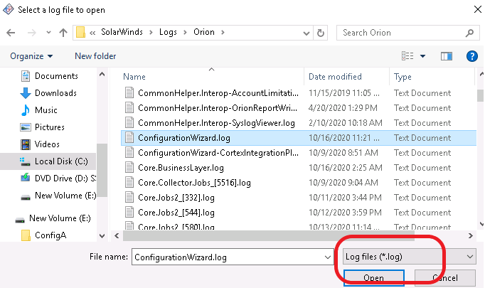

Once installation done. Click on open Configuration Wizard log file you wish to watch and track the activity and Errors during this activity .
Configuration wizard logs (ProgramData is system hidden):
C:\ProgramData\SolarWinds\Logs\Orion\ConfigurationWizard.log
Make sure you change the file type to All files.
Select your log file and open

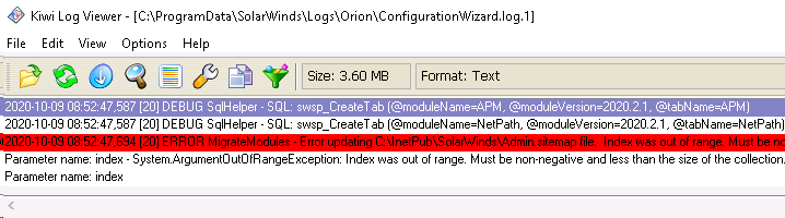

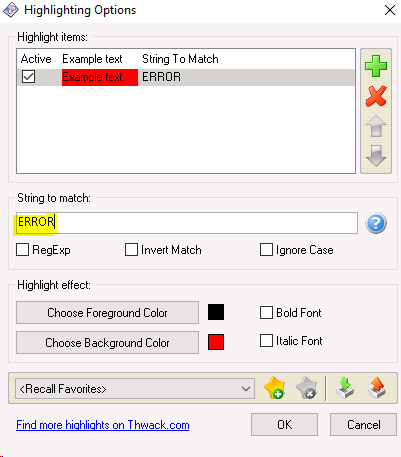

Create filter for your Errors (Make sure you type caps looks (ERROR)
Click on "Highlight" icon
Then

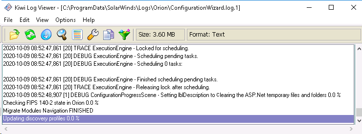

Click on the Tail icon to view the live and last activity for Configuration Wizard
Lines with ERROR will be highlighted here is an example below.
You can easily track the Time and Date and current activity on Configuration Wizard log
TIP :  There might be more than one Error . In case you have any Error reported check all the Errors there might be another Error above which is possible root cause .
