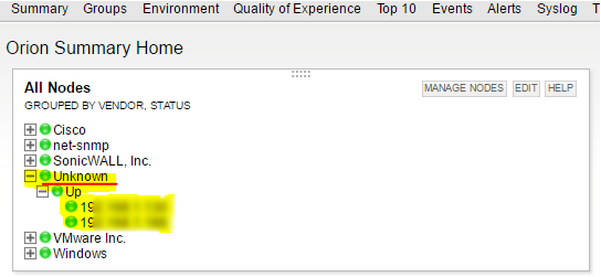

ICMP nodes added in SolarWinds Platform has unknown Vendor showing up in the webconsole. You can manually modify the vendor assigned to ICMP nodes thru the database.
Network Performance Monitor
The Vendor, MachineType, and other data are typically acquired through SNMP or WMI. The data is not available when polling via ICMP so it must be set manually.

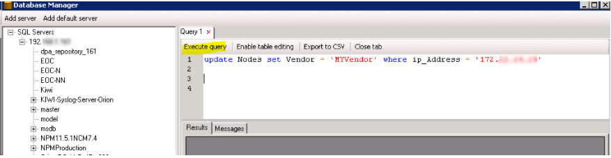

  1. Go to Start > All Programs > Solarwinds Platform > Database Manager > Add Orion Server.
  2. Right click on the NPM Database (default) SolarWindsOrion
  3. Click New Query >  Paste the following query:
UPDATE NodesData set Vendor = 'Your_Vendor_Name_Here' where ip_Address = 'Your_Node_IP_ADDRESS_Here'
        4. Click Execute Query.
For example:
UPDATE NodesData set Vendor = 'MY-ISP-NODE' where ip_Address = '192.168.1.130'

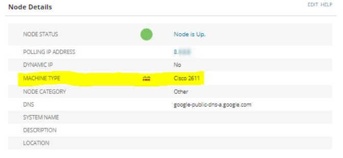

If you wish to update the Machine Type/ICON/GIF, use below SQL query.
Change the Query according to your needs.
UPDATE NodesData set Vendor = 'Cisco' where ip_Address = '8.8.8.8'
UPDATE NodesData set SysObjectID = '1.3.6.1.4.1.9.1.186' where ip_Address = '8.8.8.8'
UPDATE NodesData set MachineType = 'Cisco 2611' where ip_Address = '8.8.8.8'
UPDATE NodesData set Vendoricon = '9.gif' where ip_Address = '8.8.8.8'

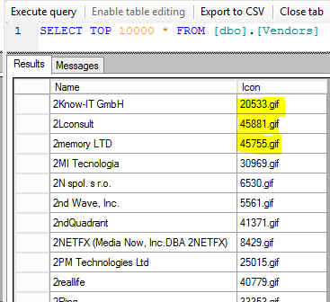

You can find the vendor icon in this location. You may add your own vendor icon here.
C:\Program Files (x86)\SolarWinds\Orion\Graphics\Vendors
