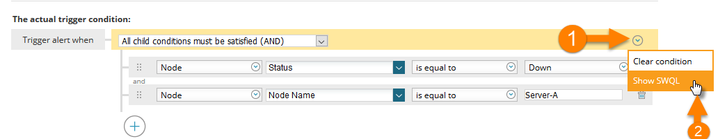

More advanced troubleshooting can be performed through the use of SWIS queries. If you're proficient enough with queries, you can utilize the generated SWQL query available on the Trigger Conditions page. Click the carrot button > "Show SWQL". Copy the SWQL in the popup dialog box.
Now to execute this query, navigate to this page in a new browser tab and fill in your specific Orion site name:
http:// [HostName/IP_Address] /Orion/admin/swis.aspx#
Execute the query to see the resulting objects that will actively fire the alert.
