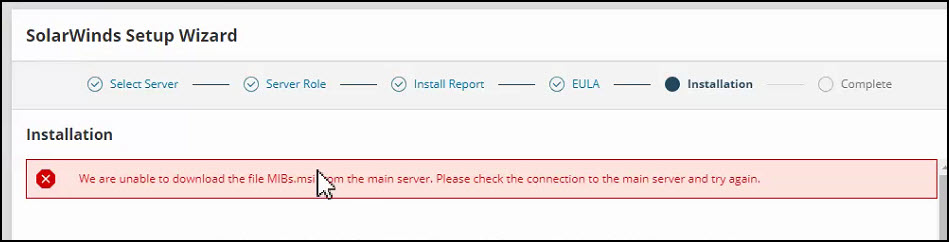

We are unable to download the file [FILENAME.msi] from the main server. Please check the connection to the main server.
This article explains the workaround if the Additional Polling Engine(s) and Additional Web Server(s) failed to upgrade Individually or through Centralized Upgrade. "Message": "Can't download file because of the invalid checksum.

If upgrading via Individual Upgrade so after downloading the installer for Scalability Engine Upgrade, you may see an error such as
"We are unable to download the file {FileName}.msi from the main server. Please check the connection to the main server."
