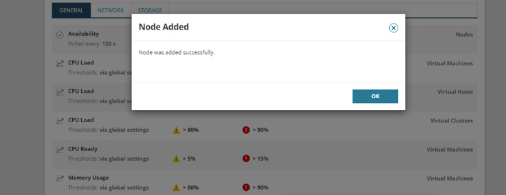

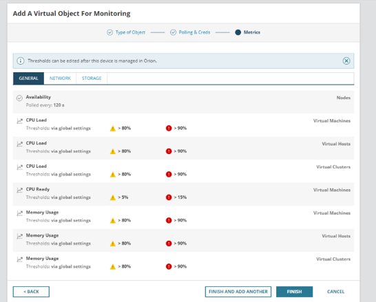

Customer is trying to add vCenter using the IP address and it showed that the node was added successfully but it does not showed in the Manage nodes page and it does not exist in the SolarWinds database.
In the ApolloWebAPi.log, we can see the following entry:
INFO SolarWinds.Orion.AddNode.WebApi.Controllers.AddNodeController - Node [Server: x.x.x.x, PluginType: vim.vmware.vcenter] was inserted
However, in the AddNodeBusinessLayer.log at the same time frame, we see the entry:
INFO SolarWinds.AddNode.BusinessLayer.Discovery.DiscoveryJobManager - Skipping of node saving to DB because an entity is not a node. This type of entity needs to be handled by a module.
