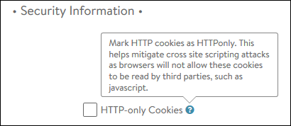

A few things may resolve this issue:
  1. Change the application profile on the load balancer.
  2. Uncheck cookie-related options as shown in the image below. If the web server was changed or rebuilt, this can especially help.
