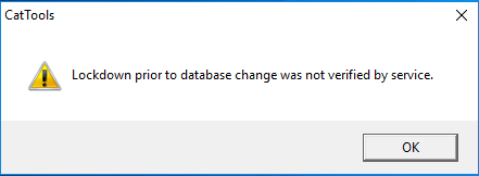

Kiwi Cattools is not launching throwing a "lockdown prior to database change was not verified by service" error
This article will provide information on how to address "lock down prior to database change was not verified by service" error when launching Kiwi Cattools

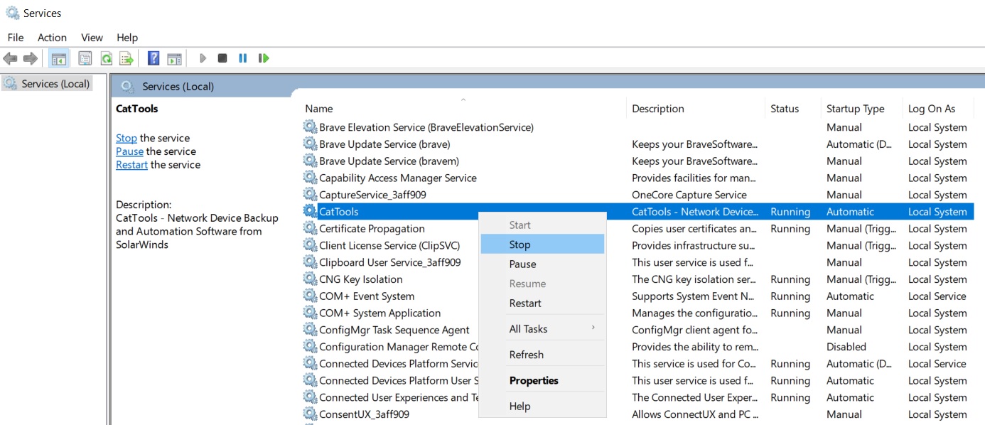

1. Open Services.msc as administrator

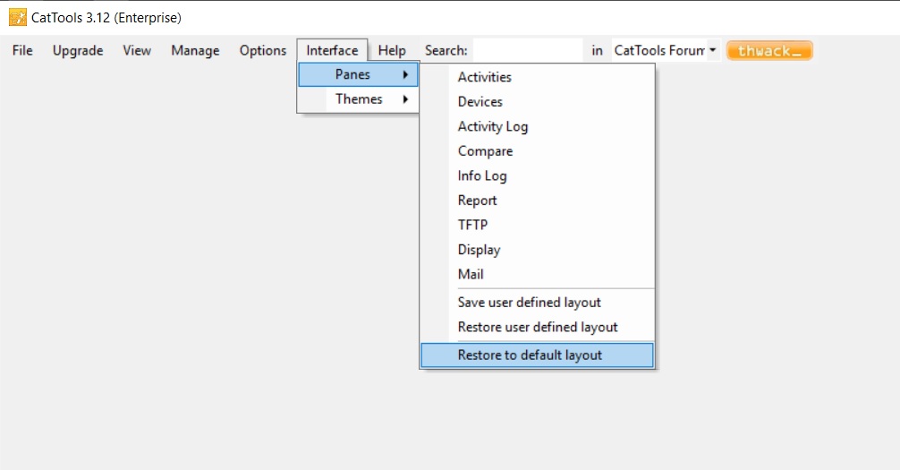

4. Once the Cattools manager is open, notice the interface is empty click on Interface > Panes > Restore to default layoutKCTpanes.jpg

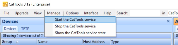

5. After restoring the interface try to start the service again from Manage > Start the Cattools Service
