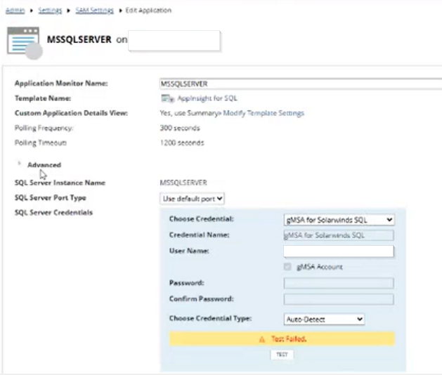

When Testing credentials in AppInsights for SQL, test connection fails when using a gMSA account.
- The application status shows:
Unable to establish SQL connection, check credentials. - Application log is missing the following indication below:
DEBUG SolarWinds.APM.Probes.Management.WinRM.WinRmConnection - User account '<gMSA Account>' is identified as gMSA
SQL-related logs show the account being used as a regular SQL login, for example
integrated security=Falsetogether withuser id=<fqdn>\<gmsa>$, followed byLogin failed for user ....
