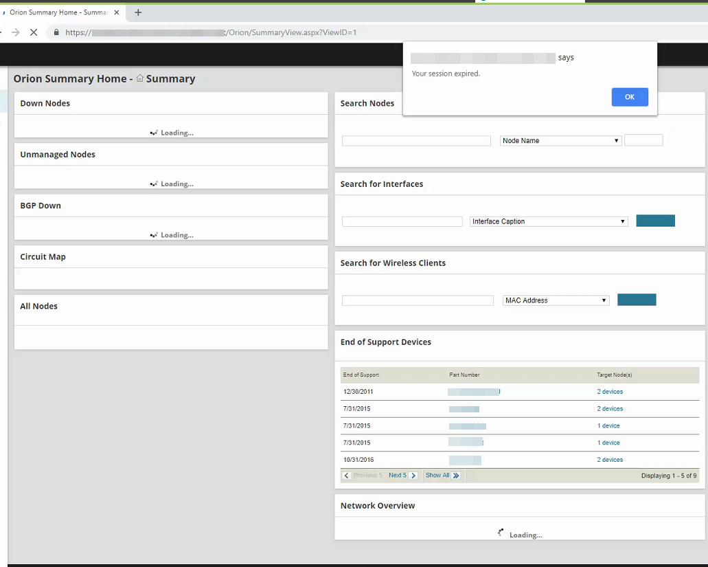

Web console is not accessible, you session expired message popup when accessing the main summary pages.
5/10/2019 9:17 PM
7/15/2025 9:37 PM

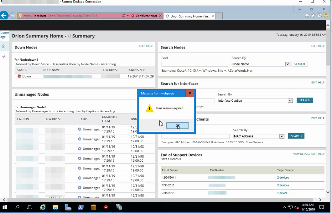

The SolarWinds Platform Web Console displays Your session expired or Unable to authenticate any Orion account (local or AD)
This can be seen on the main summary pages upon logging in.
