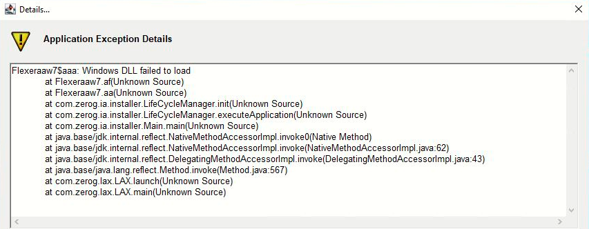

You receive following error when installing the SEM agent on Server 2019 using the local/remote agent installer 6.7.
Flexeraaw7$aaa: Windows DLL failed to load

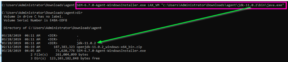

  • Install with the following workaround:
    1. Copy installer executable to the agent node.
    2. Copy some Java JVM older than 12. The example below uses OpenJdk 11.0.2. JDK doesn't have to be installed on the system.
    3. Extract JVM to folder.
    4. Run installer from command line (run CMD as Administrator) with the following syntax:
      SEM-6.7.0-Agent-WindowsInstaller.exe LAX_VM "<PATH TO THE JAVA EXECUTABLE>"
