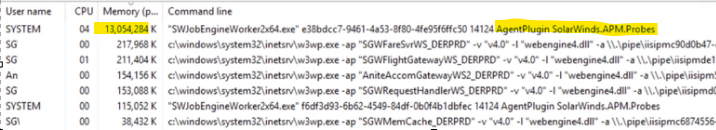

After upgrading to 2025.4, some Windows agents began to experience high memory utilization.
Examining the top processes, it is possible to identify which process is consuming the highest memory utilization.
Expanding the Command line in the task manager, you can see the Agent Plugin SolarWinds.APM.Probe spawning SWJobEngineWorker2x64.exe, and it is causing high memory utilization on the Windows Agent server.

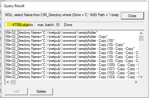

The Additional Job verifies the number of files/folders in the IIS folder (it isn’t necessarily limited to C:\inetpub\wwwroot), as Appinsight for IIS is checking every directory where the customer stores their web data files.
If the IIS folder contains multiple folders (hundreds or thousands), the memory usage by APM Probe can increase by 50 times for each folder.
It is not possible to identify the issue in the Agent debug logs, you need to take the dump of the processes which is taking high memory to capture the issue.
If you run a WBEMTest query on the IIS node, you can see the size of the folders in the IIS inetpub\wwroot folder, and the second query checks how many files are in the folder.
select FileSize from CIM_DataFile where (Drive = 'C:' AND Path = '\\inetpub\\wwwroot\\')
select Name from CIM_Directory where (Drive = 'C:' AND Path = '\\inetpub\\wwwroot\\')
