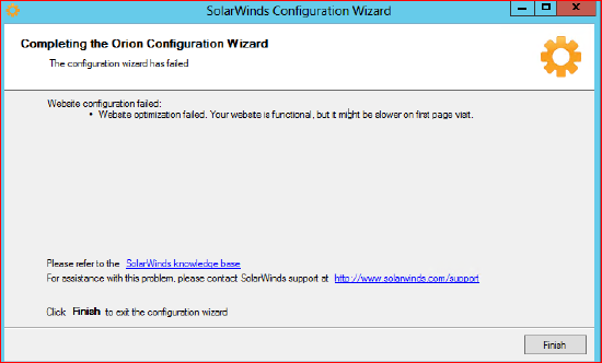

Scenario 1:
When upgrading or migrating the SolarWinds Orion server, the website optimization part may fail and generate the error message:
