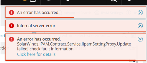

When you navigate to Manage Subnets & IP Addresses and attempt to view a subnet, the website displays an error instead of the subnet details.
Symptoms:
In the SolarWinds Web Console, you may see one or more of the following errors:
Internal server error
An error has occurred
SolarWinds.IPAM.Contract.Service.IIPamSettingsProxy.Update failed. Check fault information.
In the IPAM.BusinessLayer.log, the following error message will appear:
ERROR SolarWinds.IPAM.Contract.MessageHelper (null) - Exception caught in method SolarWinds.IPAM.Contract.Service.IIpamSettingProxy.Update
System.Data.SqlClient.SqlException (0x80131904): String or binary data would be truncated.
IP Address Manager
This issue occurs when UiSetting.SubnetIpsColumn exceeded 4000 characters limit when there are too many custom properties.
To resolve this problem please upgrade to SolarWinds Platform 2026.2.3 and above. If you cannot immediately upgrade to a fixed version, you can work around the issue by resetting and resizing the affected settings in the database.
