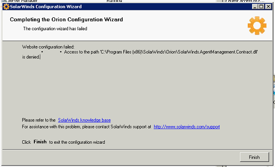

When you run the Configuration Wizard, the wizard fails with the following error:
Website configuration failed:
Access to path "C:\Program Files x86\Solarwinds\Orion\Xxxxxxxx.dll" is denied.

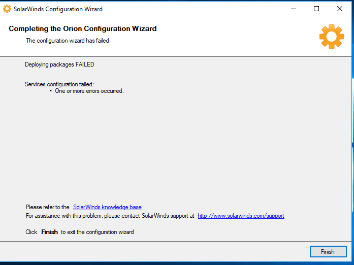

You can also get Deployment Package Failed error and when checking your ConfigurationWizard logs, you can see the above error:
