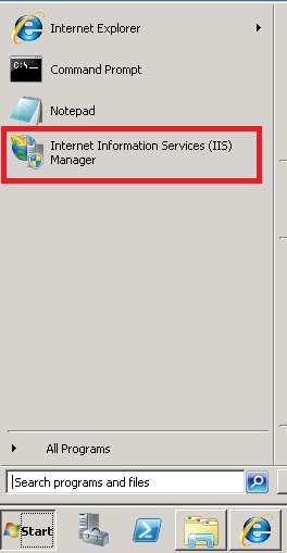

3. Open the IIS Manager and click the expansion icon + to expand your choices.
4. Click Internet Information Services, and search for the first inner window and then click the expansion icon +.

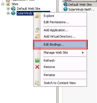

5. Check the list and confirm that the server name is listed. Click the expansion icon + and the sites.

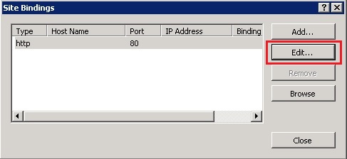

6. Click the SolarWinds website, and then select Bindings from the right-hand window.

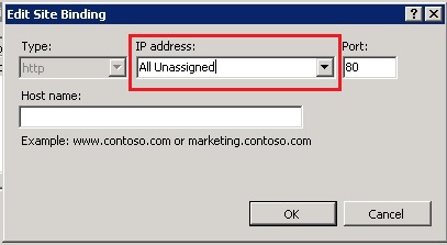

7. If this indicates the IP address of the server, select the row and select the Edit Bindings.
8. Change the IP address to all those unassigned.
