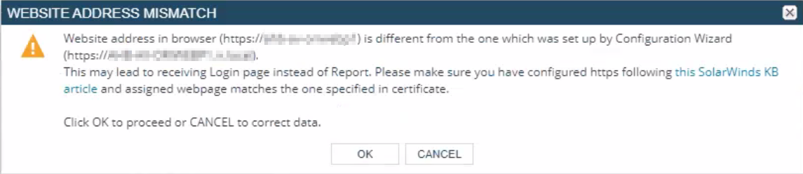

This article describes a resolution to the following Warning, you may see when editing schedule of any scheduled report in Orion Web console.
Website address in browser(xxx) is different from the one which was set up by Configuration Wizard.
This may lead to receiving Login page instead of Report.
